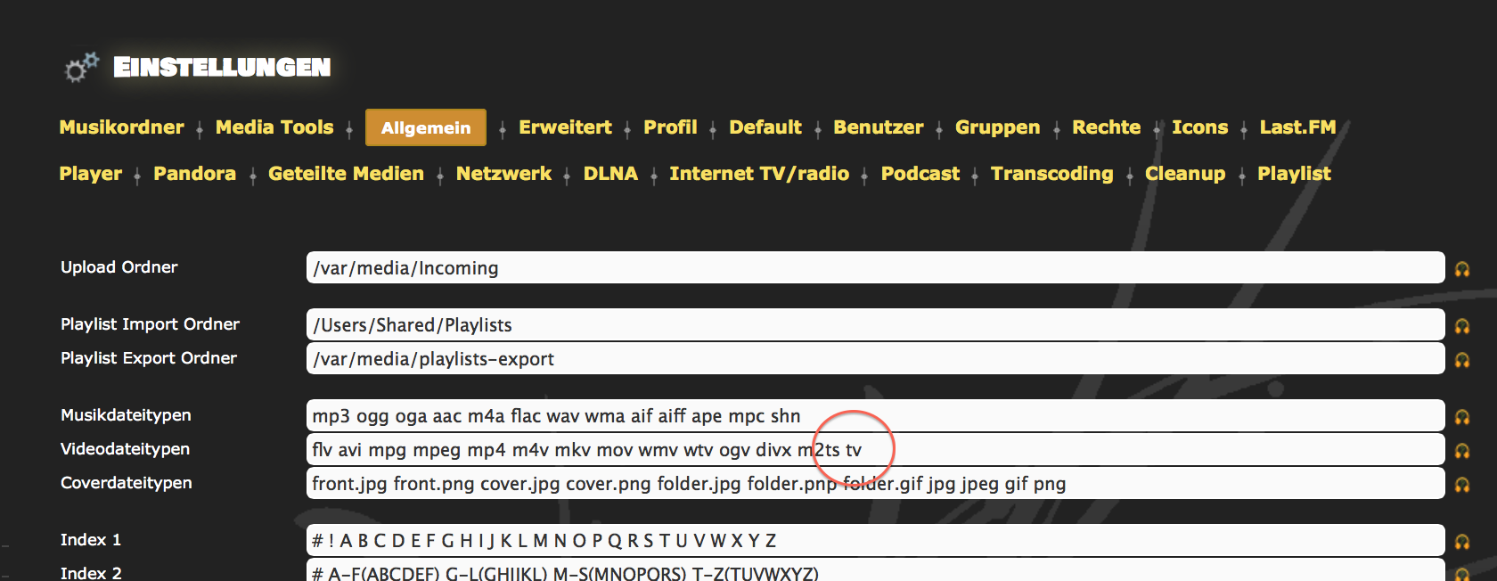

3.1. We will generate a new sort of video file using the extension ".tv"
Those are simple text files containing the HTTP URL of the TV Channels we want to receive from the Enigma2 box. Those streams are uncoded und far to big to be sent over the internet (typically mpeg2ts).

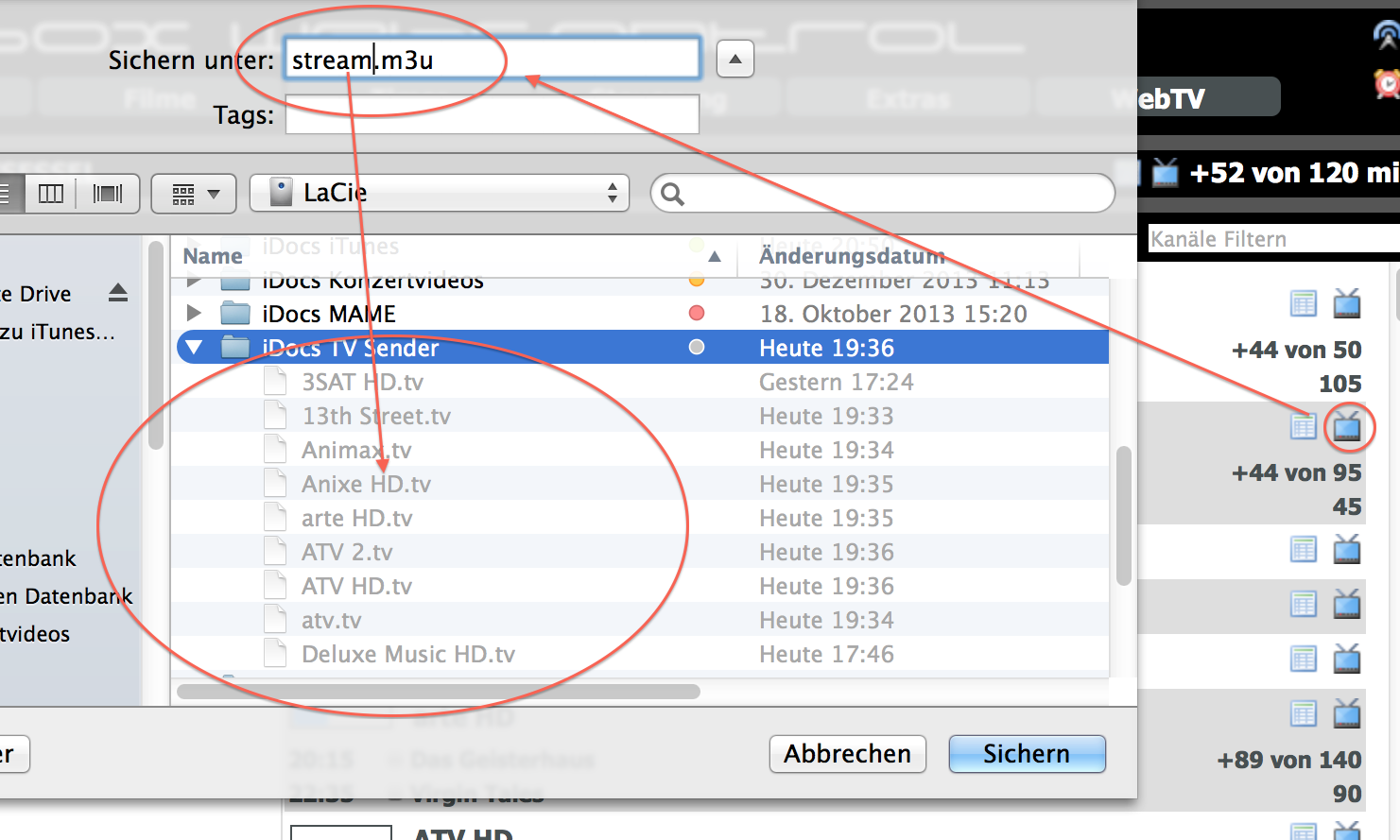

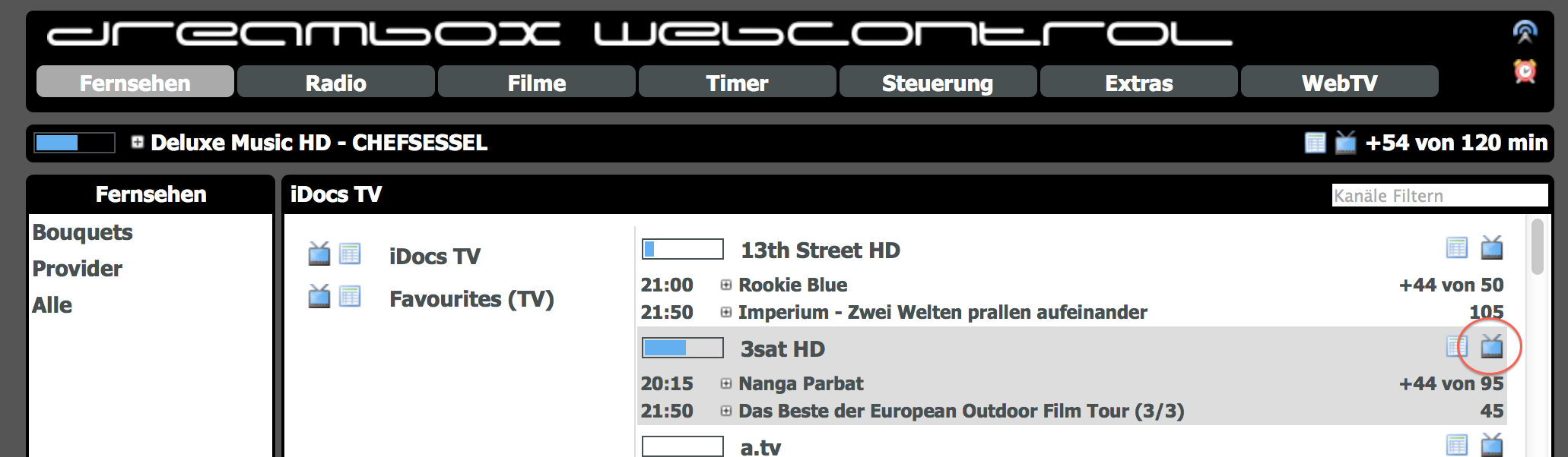

3.1.1. How do we get/make those .tv files?
Simple: Open the web UI of your Enigma2 Box, right click on the streaming button
and save that file under the new ".tv" extension. Use the filename to describe the channel - this is displayed in Madsonics media database.

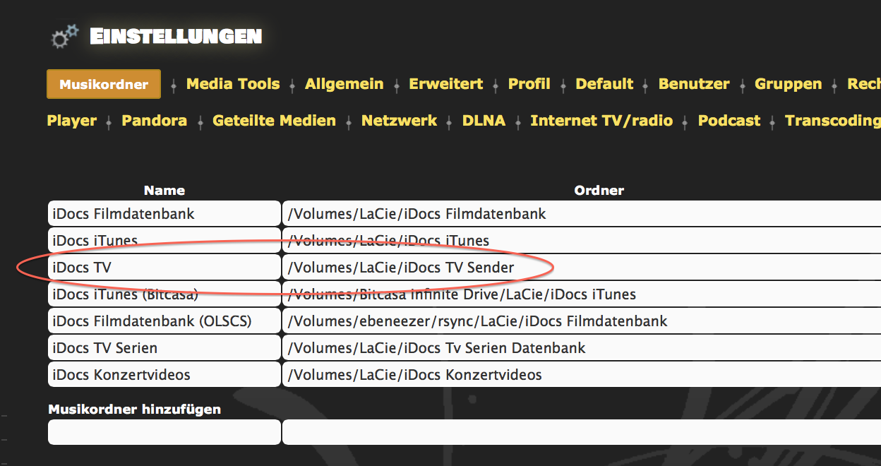

You should use a folder to hold all those files which we can tell Madsonic to generate a own folder/section for TV channels from.

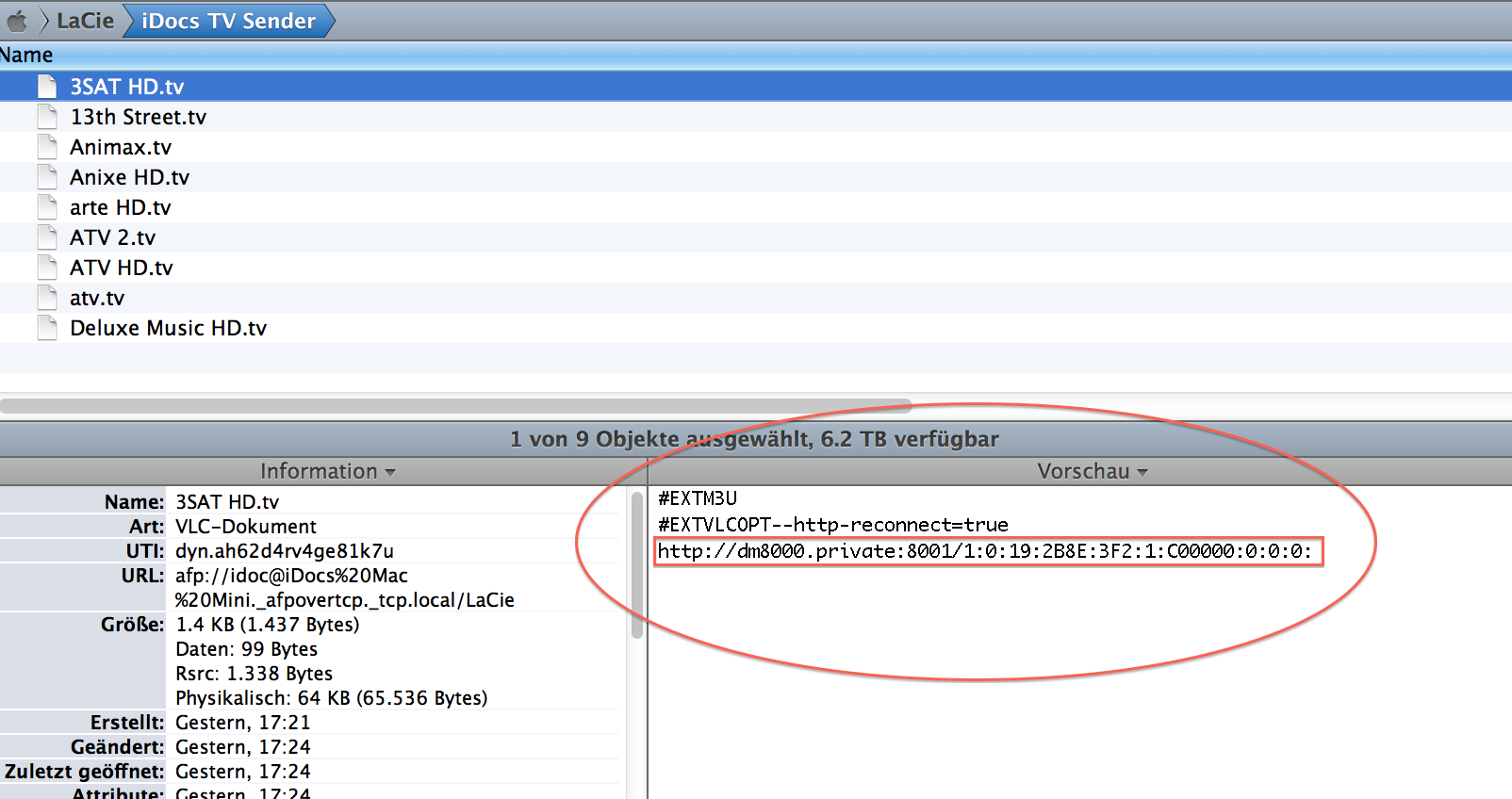

Inside the stream descriptor files you will find:
We are interested in the last line of text, which is the URL of the input mpeg2ts stream sent from the Enigma2 box towards our Madsonic transcoder. Madsonic will have to extract that last line of text from the stream descriptor open that URL and send it through ffmpeg towards the client.
Under 3.1 we already told Madsonic, that .tv files are video media files. Thus if Madsonic scans a directory containing those files all of them will be added to the video files library inside Madsonic. To keep them in place we tell Madsonic that there is a new section containing our self generated video files.

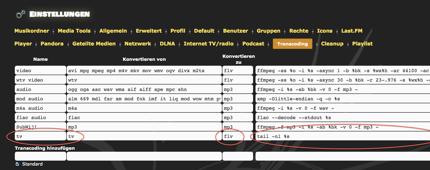

3.2. We will tell Madsonic that there is a new transcoder for .tv media files called "TV"
That transcoder is called "tv" (see screenshot) and takes ".tv" files as an input (see screenshot second field). It generates video output (obviously) which is configured as flv (see field 3). To do all that our transcoder does the following magic in three simple steps:

1. cut of the last line of text out of your .tv file (containing the stream URL as seen above)
does this for us.
2. use curl to open that URL and send the binary stream data towards step 3
3. ffmpeg takes curls output from stdin and generates a h.264 compatible output stream that is encapsulated and shaped as requested by the client via %b and all the other parameters:
Note that "-i -" parameter: ffmpeg is told to simply use stdin as input file. This is important, because ffmpeg does not have any knowledge of what it is transcoding. ffmpeg does not access the file system at any time.
Note the last parameter "-": ffmpeg is told to sent its encoded stream towards stdout. And at that end of the pipe the data is displayed by the Madsonic UI embedded player or a mobile Madsonic client.
Note that this ffmpeg transcoding is a simple copy of the basic Madsonic transcoding for video files except "-i %s" is changed into "-i -", because we have to generate our input file "on the fly".

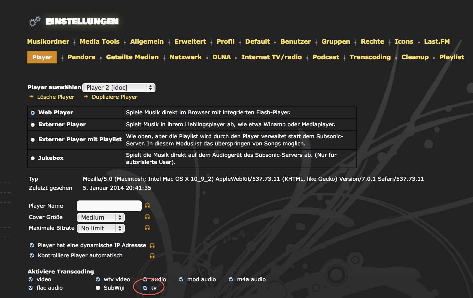

We must tell the Madsonic UI player that it should also accept "TV" transcoded streams.

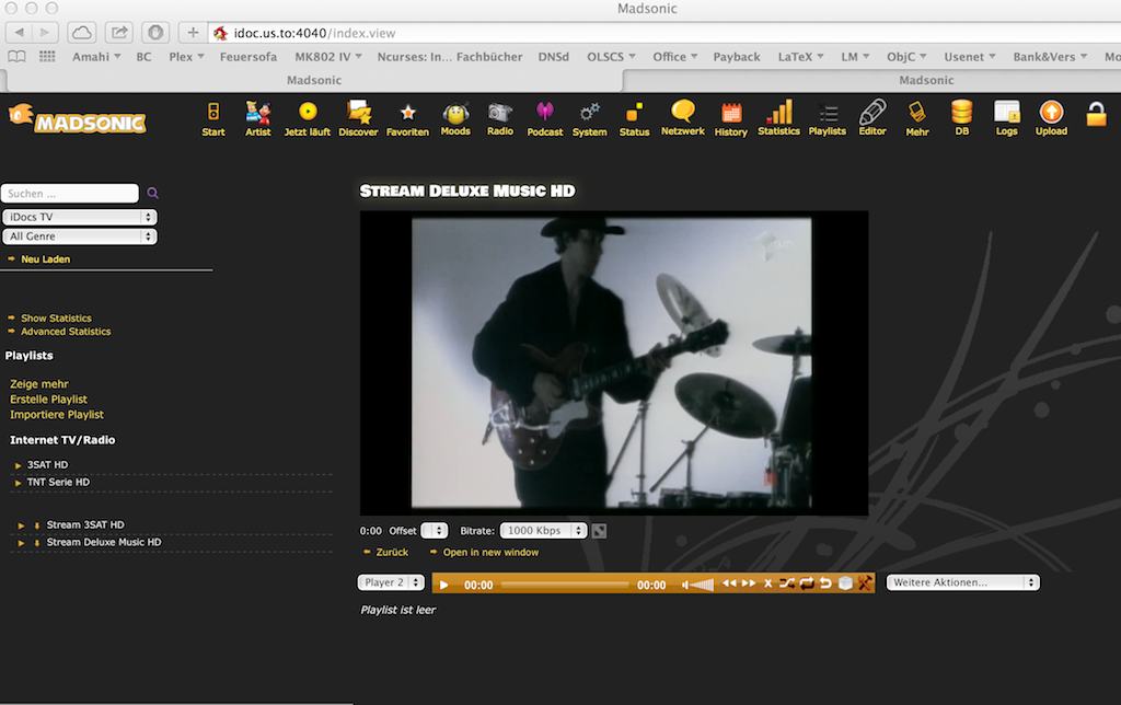

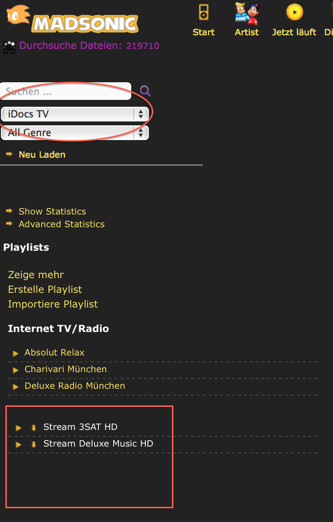

Thats it. After a Rescan of your media folders Madsonic shows a new folder (see upper circle) and the stream descriptors on the lower left side (see rectangle). Clicking on play will start our transcoder and after a few seconds the Live TV starts. You can change the bitrate - our transcoder will follow easily.

Re: [Tutorial] MadSonic / Enigma2 Transcoding Live TV
Hi O2L,
seems your stream descriptors are wrong. Following is one of my descriptors - note the correct stream URL on the last line of the file. You have to get a .ts stream from your Enigma2 box. The correct URL for that can be retrieved out of the Enigma Web UI as described in the tutorial.
Log
EG
Madsonic Stream URL for 3sat HD generated Tue Jan 28 00:01:25 CET 2014
http://dm8000.private:8001/1:0:19:2B8E:3F2:1:C00000:0:0:0:Bitrate Regards,size.
[2014-02-21 20:37:54,455] DEBUG TranscodeInputStream - Starting transcoder: [/Library/Application Support/mads
onic/transcode/tail] [-n1] [/Volumes/LaCie/iDocs TV Bouquets/iDocs TV/3sat HD.tv]
[2014-02-21 20:37:54,468] DEBUG TranscodeInputStream - Starting transcoder: [/Library/Application Support/mads
onic/transcode/xargs] [curl] [-s]
[2014-02-21 20:37:54,481] DEBUG TranscodeInputStream - Starting transcoder: [/Library/Application Support/mads
onic/transcode/ffmpeg] [-i] [-] [-async] [1] [-b:v] [1000k] [-analyzeduration] [4000] [-probesize] [10000] [-a
r] [44100] [-ac] [2] [-vcodec] [libx264] [-preset] [ultrafast] [-acodec] [libmp3lame] [-loglevel] [info] [-thr
eads] [4] [-filter:v] [yadif] [-f] [flv] [-]
Hello ebeneezer
Thx a lot to taking time to reply.
Your log help me to understand that i have to copy tail xargs and curl to the transcode folder too.
Now all works perfect.
FYI: in enigma1 the stream is send in a different port than enigma2/DM800 and with the Zapstream function the path of the stream is always the same for all channels.
I change channel direct in the webinterface (webIf) of Dreambox.
Maybe in your box the path of each stream channel activate the channel without you need to zap to the channel by remote or webIf?
Any solution to Watch the channels in apple products (no flash)?.
Thx again for your time.
