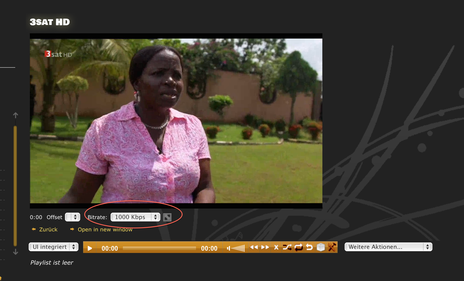

Hi Community,
i have integrated my DM8000 Enigma2 Sat HD Settop Box into MadSonic.
I am able to stream HD/SD TV with live transcoding.
My setup does not need any external programs, but uses UNIX commands like tail,curl and xargs.
Anyone interested in a howto?

Screenshot of Enigma HD Stream transcoded to 1Mbit/s by MadSonic

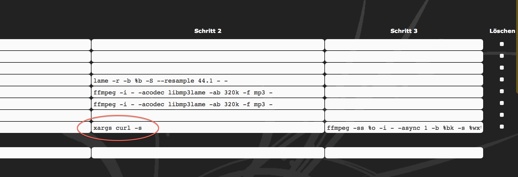

1. cut of the last line of text out of your .tv file (containing the stream URL as seen above)
tail -n1 %s
does this for us.
2. use curl to open that URL and send the binary stream data towards step 3
step 2 of your tv transcoder
3. ffmpeg takes curls output from stdin and generates a h.264 compatible output stream that is encapsulated and shaped as requested by the client via %b and all the other parameters:
ffmpeg -ss %o -i - -async 1 -b %bk -s %wx%h -ar 44100 -ac 2 -v 0 -f flv -vcodec libx264 -preset superfast -threads 0 -
Note that "-i -" parameter: ffmpeg is told to simply use stdin as input file. This is important, because ffmpeg does not have any knowledge of what it is transcoding. ffmpeg does not access the file system at any time.
Note the last parameter "-": ffmpeg is told to sent its encoded stream towards stdout. And at that end of the pipe the data is displayed by the Madsonic UI embedded player or a mobile Madsonic client.
Note that this ffmpeg transcoding is a simple copy of the basic Madsonic transcoding for video files except "-i %s" is changed into "-i -", because we have to generate our input file "on the fly".

Hi O2L,
seems your stream descriptors are wrong. Following is one of my descriptors - note the correct stream URL on the last line of the file. You have to get a .ts stream from your Enigma2 box. The correct URL for that can be retrieved out of the Enigma Web UI as described in the tutorial.
Madsonic Stream URL for 3sat HD generated Tue Jan 28 00:01:25 CET 2014
http://dm8000.private:8001/1:0:19:2B8E:3F2:1:C00000:0:0:0:
Log
size.
[2014-02-21 20:37:54,455] DEBUG TranscodeInputStream - Starting transcoder: [/Library/Application Support/mads
onic/transcode/tail] [-n1] [/Volumes/LaCie/iDocs TV Bouquets/iDocs TV/3sat HD.tv]
[2014-02-21 20:37:54,468] DEBUG TranscodeInputStream - Starting transcoder: [/Library/Application Support/mads
onic/transcode/xargs] [curl] [-s]
[2014-02-21 20:37:54,481] DEBUG TranscodeInputStream - Starting transcoder: [/Library/Application Support/mads
onic/transcode/ffmpeg] [-i] [-] [-async] [1] [-b:v] [1000k] [-analyzeduration] [4000] [-probesize] [10000] [-a
r] [44100] [-ac] [2] [-vcodec] [libx264] [-preset] [ultrafast] [-acodec] [libmp3lame] [-loglevel] [info] [-thr
eads] [4] [-filter:v] [yadif] [-f] [flv] [-]
[2014-02-21 20:37:54,611] DEBUG InputStreamReaderThread - (/Library/Application Support/madsonic/transcode/ffm
peg) ffmpeg version 2.1.git-a044a18 Copyright (c) 2000-2013 the FFmpeg developers
peg) built on Jan 7 2014 14:10:02 with Apple LLVM version 5.0 (clang-500.2.79) (based on LLVM 3.3svn)
peg) configuration: --prefix=/opt/local --enable-swscale --enable-avfilter --enable-avresample --enable-libm
p3lame --enable-libvorbis --enable-libopus --enable-libtheora --enable-libschroedinger --enable-libopenjpeg --
enable-libmodplug --enable-libvpx --enable-libspeex --enable-libass --enable-libbluray --enable-gnutls --enabl
e-libfreetype --disable-indev=jack --disable-outdev=xv --mandir=/opt/local/share/man --enable-shared --enable-
pthreads --cc=/usr/bin/clang --arch=x86_64 --enable-yasm --enable-gpl --enable-postproc --enable-libx264 --ena
ble-libxvid --enable-nonfree --enable-libfaac
[2014-02-21 20:37:54,615] DEBUG InputStreamReaderThread - (/Library/Application Support/madsonic/transcode/ffm
peg) libavutil 52. 56.100 / 52. 56.100
peg) libavcodec 55. 45.100 / 55. 45.100
peg) libavformat 55. 22.100 / 55. 22.100
peg) libavdevice 55. 5.102 / 55. 5.102
[2014-02-21 20:37:54,615] DEBUG InputStreamReaderThread - (/Library/Application Support/madsonic/transcode/ffmpeg) libavfilter 3. 92.100 / 3. 92.100
[2014-02-21 20:37:54,615] DEBUG InputStreamReaderThread - (/Library/Application Support/madsonic/transcode/ffmpeg) libavresample 1. 1. 0 / 1. 1. 0
Bitrate
Dynamic bitrate selection
