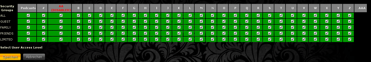

I guess the "rights management console" is a bit buggy ??
If you have several folders ... 28 +
i.e. podcast, # and alpabetical order ( a,b,c,...,z)
and you add another one, there are no settings available
Anyone seen this before ?
