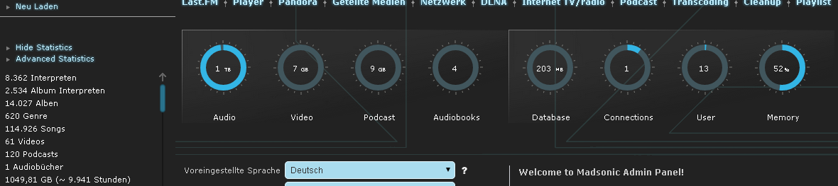

Will the graph showing the amount of GB / TB of the files go any further after reaching 1 TB ?
Like 1,1 TB ? Or will it just remain as is ?
