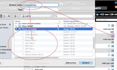

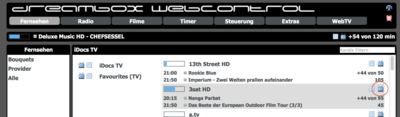

Simple: Open the web UI of your Enigma2 Box, right click on the streaming button
- Right click and save the .m3u stream info file
and save that file under the new ".tv" extension. Use the filename to describe the channel - this is displayed in Madsonics media database.
You should use a folder to hold all those files which we can tell Madsonic to generate a own folder/section for TV channels from.
- saving stream info file under new name and extension into our new folder of TV stream info files

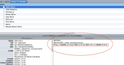

Inside the stream descriptor files you will find:
- inside an Enigma2 stream descriptor
We are interested in the last line of text, which is the URL of the input mpeg2ts stream sent from the Enigma2 box towards our Madsonic transcoder. Madsonic will have to extract that last line of text from the stream descriptor open that URL and send it through ffmpeg towards the client.

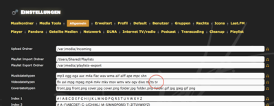

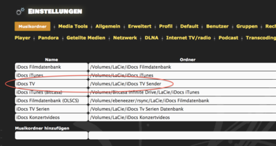

Under 3.1 we already told Madsonic, that .tv files are video media files. Thus if Madsonic scans a directory containing those files all of them will be added to the video files library inside Madsonic. To keep them in place we tell Madsonic that there is a new section containing our self generated video files.
- new section for TV channels containing our self generated file descriptors

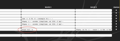

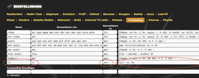

3.2. We will tell Madsonic that there is a new transcoder for .tv media files called "TV"
- a new born transcoder inside Madsonic
That transcoder is called "tv" (see screenshot) and takes ".tv" files as an input (see screenshot second field). It generates video output (obviously) which is configured as flv (see field 3). To do all that our transcoder does the following magic in three simple steps:

1. cut of the last line of text out of your .tv file (containing the stream URL as seen above)
does this for us.
2. use curl to open that URL and send the binary stream data towards step 3
- step 2 of your tv transcoder

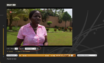

3.3 Last step

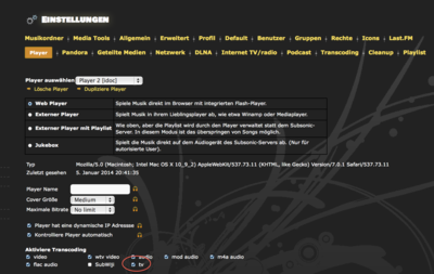

We must tell the Madsonic UI player that it should also accept "TV" transcoded streams.
- embedded player is also responsible for .tv files

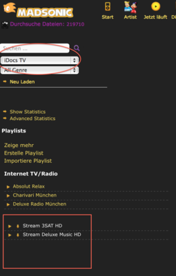

Thats it. After a Rescan of your media folders Madsonic shows a new folder (see upper circle) and the stream descriptors on the lower left side (see rectangle). Clicking on play will start our transcoder and after a few seconds the Live TV starts. You can change the bitrate - our transcoder will follow easily.
If you like what I have done please leave a comment.
Regards, Ebeneezer.
- Magic done.

Most important, do you can change bitrate for the tv stream? (i wan't the tv stream outside of my network)
Where can i activate a log in madsonic or ffmpeg more verbose ? to understand what's occur.
Re: [Tutorial] MadSonic / Enigma2 Transcoding Live TV
Posted: 21 Feb 2014, 06:58
by ebeneezer
can you post the complete content of one of your .tv files?
And a system log of madsonic with debug setting exactly at the point where you start the tv streaming.
What kind of client do you use?
And last: Yes, you can change the bitrate on-the-fly within the flash player while streaming.

Hello ebeneezer
Thx a lot to taking time to reply.
Your log help me to understand that i have to copy tail xargs and curl to the transcode folder too.
Now all works perfect.
FYI: in enigma1 the stream is send in a different port than enigma2/DM800 and with the Zapstream function the path of the stream is always the same for all channels.
I change channel direct in the webinterface (webIf) of Dreambox.
Maybe in your box the path of each stream channel activate the channel without you need to zap to the channel by remote or webIf?
Any solution to Watch the channels in apple products (no flash)?.
Thx again for your time.
Posted: 23 Feb 2014, 10:11
by ebeneezer
Glad it worked - but may i cite from the tutorial:
All those commands must reside in the Madsonic transcoding folder (see explanation inside Madsonic UI).
Regards,
Ebeneezer
