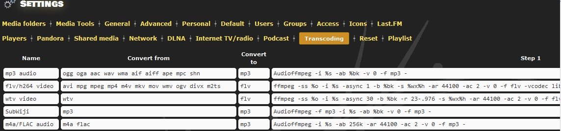

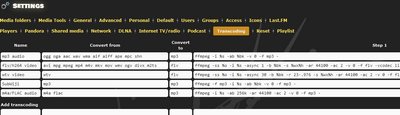

in the Transcode setting, the default, newly installed settings said, Audioffmpeg, instead of ffmpeg
see attached images
based on ubuntu install using "sudo dpkg -i 20131130_madsonic-5.0.3800.deb"
i just manually removed the "Audio" from each instance of Audioffmpeg
see attached images
