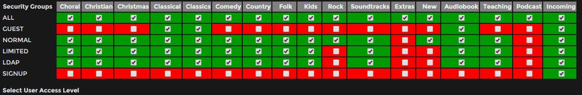

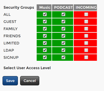

Question though...I don't see the Incoming folder listed in the folder list. Do I have to go into the folder directly on the file system to see the uploads, or is there a maximum number of media folders that can be setup? My access screen looks like this:
access list
access list
The last column looks to be my podcast folder, it's the only one missing from the headers.
Thanks for the quick help on this one. I have a user that has been waiting for this to work. Now I know I was the blocker due to configuration. Is the incoming folder config noted in any setup doc anywhere? I've never seen it before.

Checked again this evening and now that last column has the "Incoming" header, so now the table looks correct:
