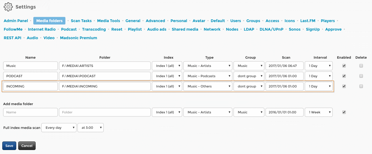

I currently do not want the uploads going to media directory because I want to screen, fix tags, and rename files before I move them into a media folder, however, I never even thought about uploading to a media directory anyway.
Re: Upload not working
troycarpenter wrote:Let me check those things.
just fix this with the access rights Settings > Access upload still work

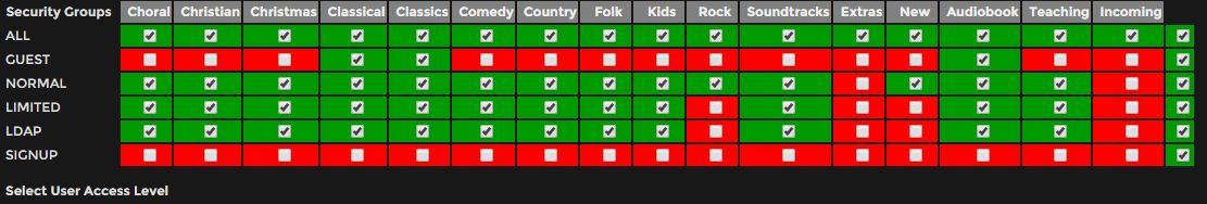

Wow...All this time and that was all it took to get it to work. Once I added it as a media folder, I was able to upload as myself (the only one I gave access to that folder), and as a normal user who didn't have access. Both time the upload was successful.
Question though...I don't see the Incoming folder listed in the folder list. Do I have to go into the folder directly on the file system to see the uploads, or is there a maximum number of media folders that can be setup? My access screen looks like this:
access list
access list
The last column looks to be my podcast folder, it's the only one missing from the headers.
Thanks for the quick help on this one. I have a user that has been waiting for this to work. Now I know I was the blocker due to configuration. Is the incoming folder config noted in any setup doc anywhere? I've never seen it before.

I guess time heals all problems (not really, but hey, it fits here).
Checked again this evening and now that last column has the "Incoming" header, so now the table looks correct:
