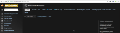

 DESCRIPTION: Settings doesn't open
 REPRODUCIBLE: YES
After clicking on Settings, Chrome block the frame and i got this message:
These users thanked the author huggenknubbel for the post:

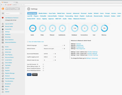

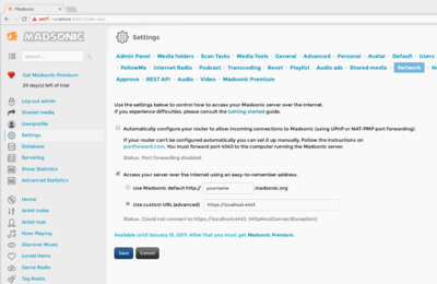

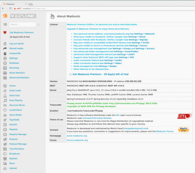

here is a sample default installation on a debian 8.6 virtual machine to check your installation.
SETUP
 VERSION:      MADSONIC 6.2 | BUILD: 9040
 SERVLET:      JETTY
 SERVER:       CPU: ICORE7 | ARCH: X64 | MEMORY: 32GB | HDD: 1TB
 OS:           DEBIAN 8.6
 SYSTEM:       SERVER
 INSTALLER:    DEB
 JAVA:         ORACLE JDK 1.8.111
 BROWSER:      CHROME  55.0.2883.87
 CLIENT:       MADSONIC 6.2
JAVA
# java -version
java version "1.8.0_111"
Java(TM) SE Runtime Environment (build 1.8.0_111-b14)
Java HotSpot(TM) 64-Bit Server VM (build 25.111-b14, mixed mode)
INSTALL
#dpkg -i Madsonic-6.2.9040.deb
SETTINGS
etc/default/madsonic
# This is the configuration file for the Madsonic service
# (/etc/init.d/madsonic)
# To change the startup parameters of Madsonic, modify
# the MADSONIC_ARGS variable below.
MADSONIC_ARGS="--port=4040 --https-port=4443 --init-memory=128 --max-memory=512"
MADSONIC_USER=root
RESTART
#service madsonic stop
#service madsonic start
LOGS
/var/madsonic/madsonic_sh.log
2016-12-14 13:44:18.757:INFO:/:Initializing Spring FrameworkServlet 'madsonic'
2016-12-14 13:44:19.747:INFO:oejs.AbstractConnector:Started @0.0.0.0:4040
2016-12-14 13:44:19.877:INFO:oejus.SslContextFactory:Enabled Protocols [TLSv1, TLSv1.1, TLSv1.2] of [SSLv2Hello, SSLv3, TLSv1, TLSv1.1, TLSv1.2]
2016-12-14 13:44:19.885:INFO:oejs.AbstractConnector:Started SslSocketConnector@0.0.0.0:4443
Madsonic running on: http://localhost:4040/
                and: https://localhost:4443/
GUI
Hope this little install guide will help you :)
