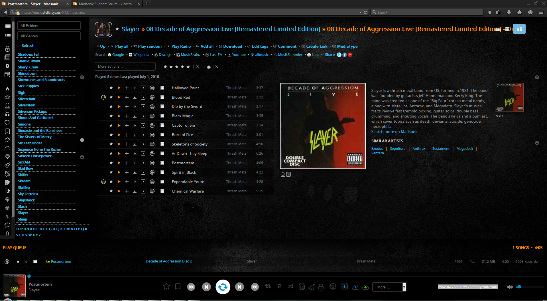

Lately i've been having a problem with FLAC playback in particular when Madsonic is trying to transcode to MP3, I know for a fact that if I convert the tracks to OGG they play fine but id like to keep the 4,800 something albums I have in the library vs converting each of them just to fix this. I have never once had this problem with Subsonic and am unsure as to what in Madsonic is causing this. I have posted a screenshot of something I came across when trying to play one of my FLAC files, however strangely enough this doesnt always show up.
I have highlighted in the attached screenshot on the play queue at the bottom right what problem I noticed.
