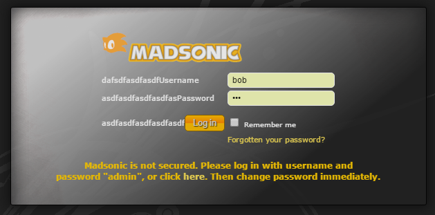

I customize my installs. I installed 6 to check it out and again, it looks like you can't edit the jsp files.
Is there a trick to bypass the caching like there was in previous versions?
If so, could we get instructions?

this comes from the precompiled JSP files of the default jetty version, you can simple use the madsonic tomcat version which don't use this. ;)
simple test of editing files from
\Madsonic\jetty\5260\webapp\WEB-INF\jsp
Hope this help you :D

There's no way to edit via the Jetty installs? Your link references Jetty and 5260. I'm trying to edit the jsp on 7200. Are you moving the Tomcat files over to a Jetty install?
Re: Editing JSP Files
yes of course, this works! :D
replace your jetty war with the tomcat war file! That's do the trick!

Awesome! I'm up and running.
