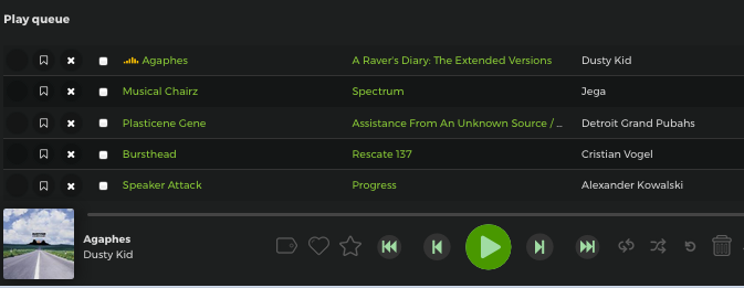

I accidentially pressed the RELOAD-Button on the madsonic webgui, forcing the whole webgui to reload and stop the music.

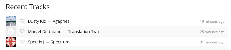

This song " Dusty Kid — Agaphes " stucks in the playbar, but was never started/played.
last.fm, however, shows that song as a scrobbled song.
(you see in this screenshot, that the music stopped afer " Dusty Kid — Agaphes ". In real life, it stopped while playing "Marcel Dettmann — Translation Two", because on that song, I pressed PAUSE, then accidentialle reloaded the webgui
