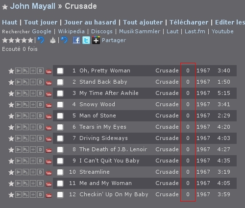

There is a little problem with MP3 tags, I d'ont speak english very well, I try to explain with pics
for example in this pic genre is 0
I use Easytag to modify mp3 tags and the same album in easytag genre is good Blues
And now I have a lot of mp3 where genre are numbers and editing tag give me a lot of numbers
I have a lot of albums in which tags are not good in Madsonic but are good in easytag
How can I fix that ?
Is there a mod to for tags management ?
Thanks a lot

Hello and thank you.
after having read the message that you have indicated I used Puddletag and Easytag to remove ID3v1 tag from all my mp3
In Easytag there is a function to write the genres in text format only
after performing operations on all my mp3 collection
I deleted Madsonic database an make a full rescan and I always have some genres in number format
I make all the operations two times and same result
I use Easytag to rewrite ID3v2.4 tag and delete again Madsonic database and full rescan and same result always have genre in number format
I do not know what to do

can you send me an example?
or try http://www.mp3tag.de/en/index.html what genre you get from your files.
Info about tag mapping --> http://www.jthink.net/jaudiotagger/tagmapping.html

Hello, I removed completely madsonic then I re-installed it and I started a full scan again and now everything is perfect
