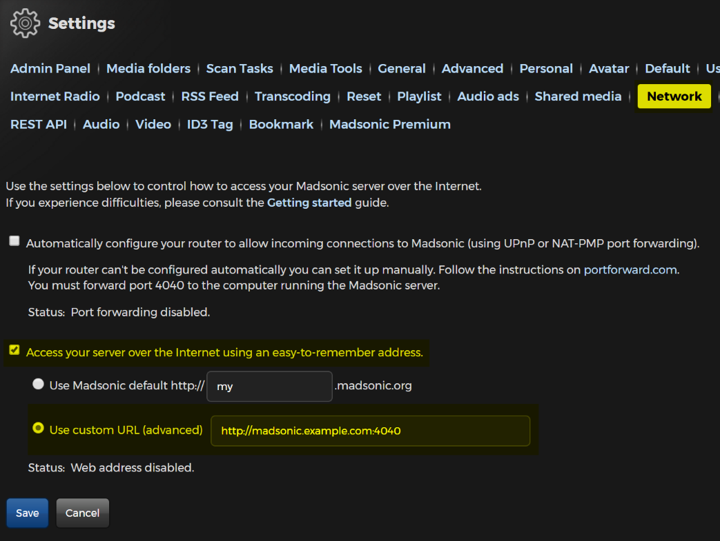

try to bring the Madsonic server to the same ip subnet (192.168.0.x) Sonos products can't broadcast to different subnets.
to config your Madsonic url rewriter go to Settings > Network

thanks for your help. I tried to change it but get the following error:
Status: Could not connect to http://192.168.0.38:4040. (HttpHostConnectException)
