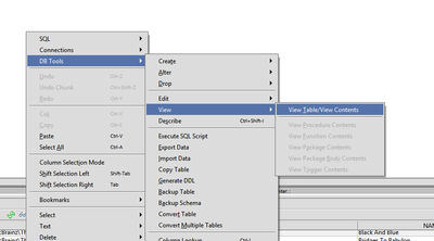

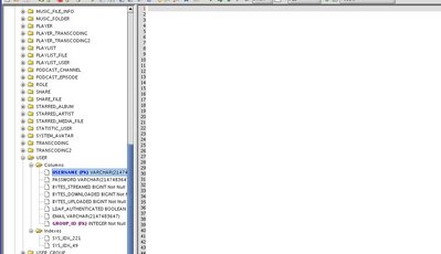

Re: Accessing Madsonic database
I've connected to the db, but I am not seeing any data. I can see table names, but that's about it.
See attachment, I have highlighted "username (pk)" on the left, but nothing shows on the right. Same for anything I highlight.
