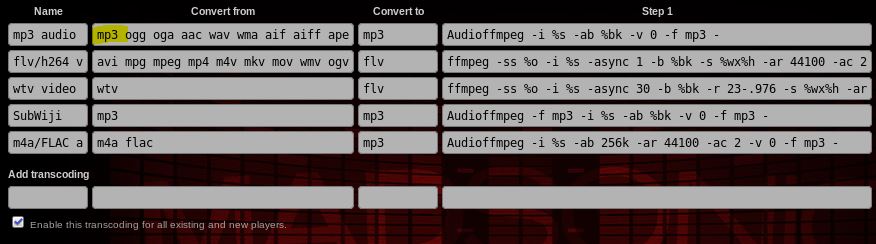

I believe I have found a possible issue with MadSonic (and Subsonic) and its use of ffmpeg to transcode music into streaming MP3 format.
I am running MadSonic 4.8 beta 3 on Centoa 6.3 and had a terminal window open and I started seeing messages similar to this:
*** glibc detected *** /var/subsonic/transcode/ffmpeg: double free or corruption (!prev): 0x09ba4b40 ***

Totally seems to be an ffmpeg error, so I looked it up, and found a few resources pointing to attempting to run the program under valgrind. So I installed that and ran Subsonic through valgrind, and came up with this:
==1702== Memcheck, a memory error detector

Tried running the same on ffmpeg itself, but even when running from the /var/subsonic/transcode folder, it can't seem to "find" the ffmpeg executable...

Unread post by gurutech »
Posted a possible solution over on SubSonic forum. Basically, it involves adding "mp3" to the transcoding "from" section and saving settings. See attachment...
