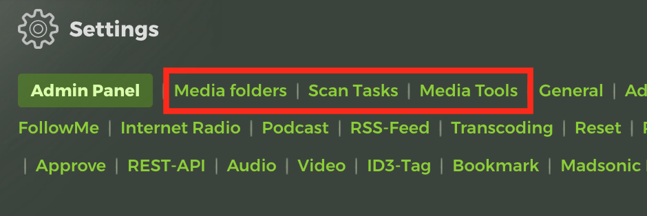

Check those Places: There you can re-scan your files and configure a time interval for auto scanning.sayyidilmy wrote:any solution?
Also, try/read this Thread. It gives good information about what can going wrong.
