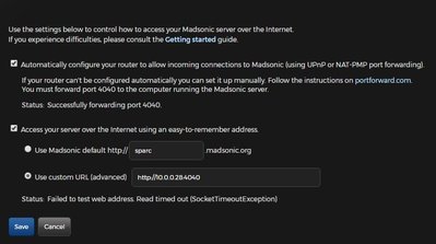

Thanks for the response; however, no luck. I was using a custom URL that resolves properly internally to my internal Madsonic IP & externally to my WAN IP address. DNS was definitely setup properly. Externally & internally, I can access it.. so I have no reason to believe the NVIDIA Shield can't internally. I tried using a custom Madsonic address (that registered successfully), my own personal custom DNS, & my internal IP address with no success. I have to put :4040 on the end to pass the status check on the personal DNS one.Madevil wrote:I suspect it will not use the correct network address.
Go to Settings > Network
and configure your network address to match the local IP of your Madsonic server so that other devices can find your server.
See attached.
