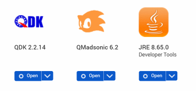

OK, silly me... :oops:
I've apparently mixed JRE with JDK and had only JDK, not JRE, installed. Just fixed that, upgraded again to Madsonic to 6.2 and... I can log in, but everything is gone - I need to set up all server from the scratch! :(
Is that normal? And BTW - do I have to have JDK installed as well, or will just JRE do?

just installed default JRE package and its the only needed requirement
At the moment the installer doesn't support export/import but will be implemented in an upcoming version. :D
