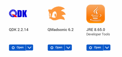

I've apparently mixed JRE with JDK and had only JDK, not JRE, installed. Just fixed that, upgraded again to Madsonic to 6.2 and... I can log in, but everything is gone - I need to set up all server from the scratch! :(
Is that normal? And BTW - do I have to have JDK installed as well, or will just JRE do?

just installed default JRE package and its the only needed requirement
