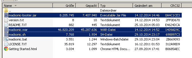

sure, use the standalone version, you can trigger it starting stopping via scripts . but i think you have to do some research HOW TO : ) i just know linux ^^

hi, sry 4 late reply ... the stanalone version is not that standalone . at least is comes with 3 files : )
you need the 3 highlighted. launchd points at the .sh file - here you can fine tune some settings.
the .sh file pipes these settings to the booter.jar
and the booter jar fires up the war file.
nothing special - in most cases : P
