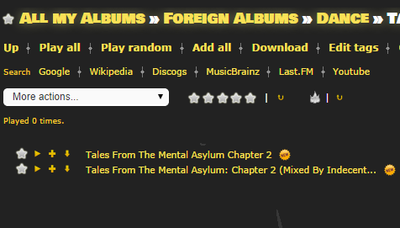

On my example I have the very same album as mixed and unmixed songs together with their split version of the songs. It seems that although Subsonic can display all 3 folders Madsonic can only display 2.
screenshot from Subsonic
2014-09-23 17_27_51-Clipboard.png (11.19 KiB) Viewed 9787 times
Screenshot from Madsonic
If it would be possible to switch views of folder structure from ID3Tag to folder name I think the issue would be gone. Do you think this can be an option?

Dear friend. The case is not related at all with the 255 characters length. The way I see it is like the name of the folder is defined with the Album value of the songs that are inside that folder. Though in cases like mine where I keep the same album with mixed and unmixed versions as the Album value is remain the same on both folders finally only one entry is displayed.
In the end the below happens:
Folder Structure (windows explorer)
Album
|- mixed
|- unmixed
Folder Structure (Madsonic)
Album Folder Name
|- Album Title (from ID3 Tag)
|- ...... (entry is missing)
