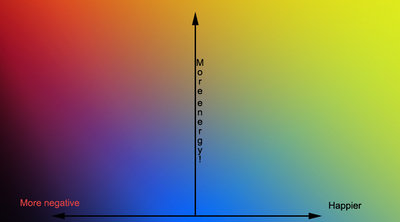

Idea for implementation (replacement for moods.jsp or in parallel) I was having a look at an idea based on a Mood plane (x-y, negative/positve - energy) to allow a user to create a playlist based on a graphical one touch plane such as the attached jpg, particularly useful imo on tablets, but also on pc with a mouse.
- Touch image for emotions in x-y plane
I had a go at implementing it simply (requires a an array of translation for the last.fm moods etc on an x-y basis) in js which was fine but i then tried to replace the moods.jsp in the *.war file so that it would be compiled into the webapp but it didn't seem to work.
I am not sure if I am "allowed" mess like this but I think this feature would be a great intuitive way of creating playlists.
My question is - 1) how could I ensure that my new moods.jps file is installed/booted in the webapp (debian/linux) or 2) would you like to see the idea in code for potential implementation?!
Thanks for your time, and your great work thus far!
(I had not coded for years before this so had to give myself a few days crash course in js to get going(actually had never done any js before)!)

P.S. The complication with this mood plane idea is that X-Y coordinates for moods are not "Official" and would have to just be accepted - not that small differences should be a big deal for anyone. I have not been able to find a full list of last.fm available moods so cannot do a "full mapping to x-y" - I believe the list is dynamic anyway is it?

Thats quite an old thread, but is anybody (still) using this and could create a video or something on how this is working in real life?
Looks very interesting and I wonder, how to use it in madsonic webgui.
ciantm wrote:Idea for implementation (replacement for moods.jsp or in parallel) I was having a look at an idea based on a Mood plane (x-y, negative/positve - energy) to allow a user to create a playlist based on a graphical one touch plane such as the attached jpg, particularly useful imo on tablets, but also on pc with a mouse
