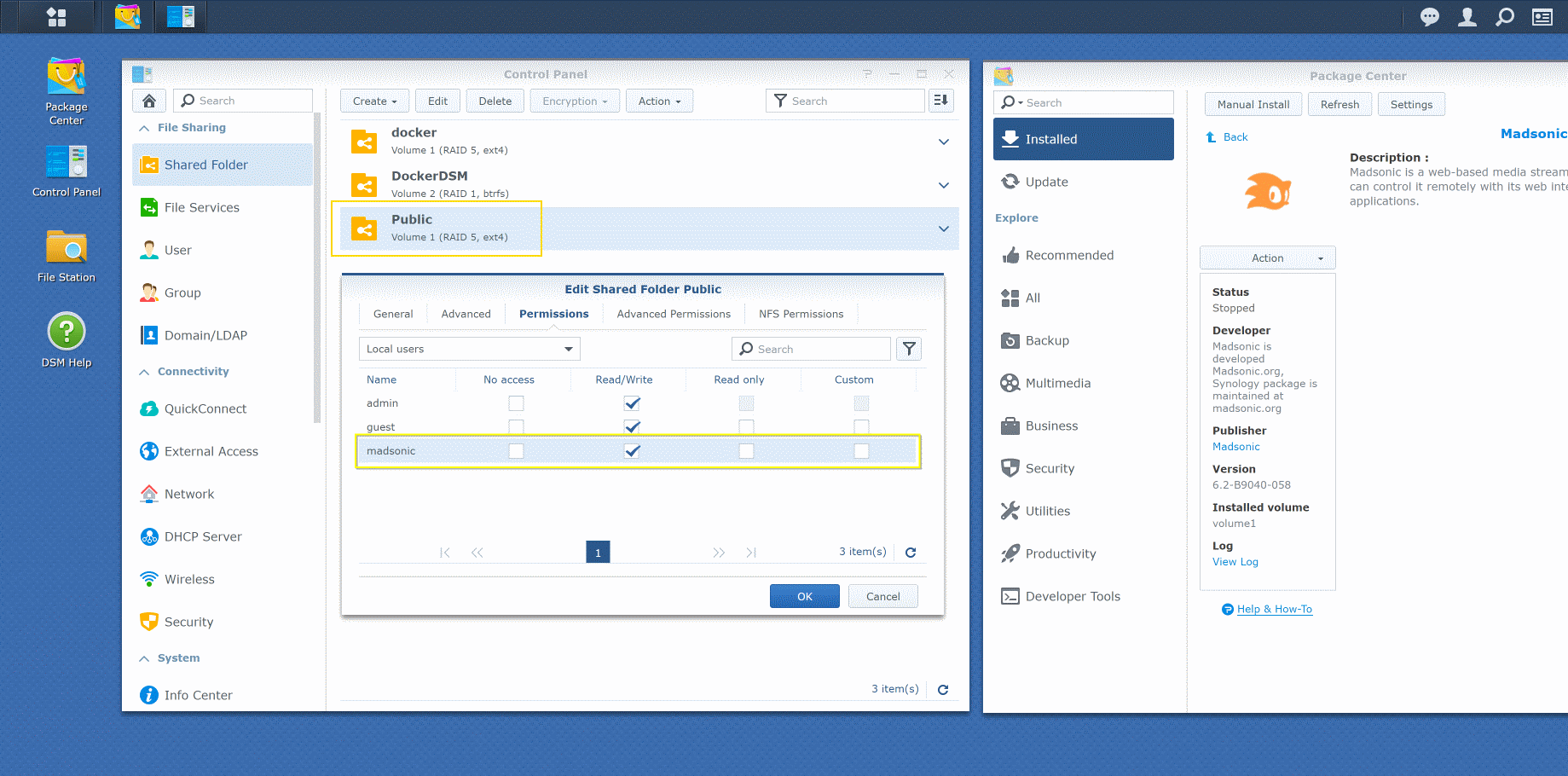

BTW: not a folder called Public is needed, a Volume called Public is needed

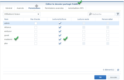

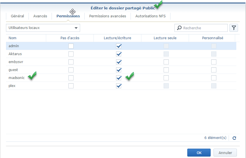

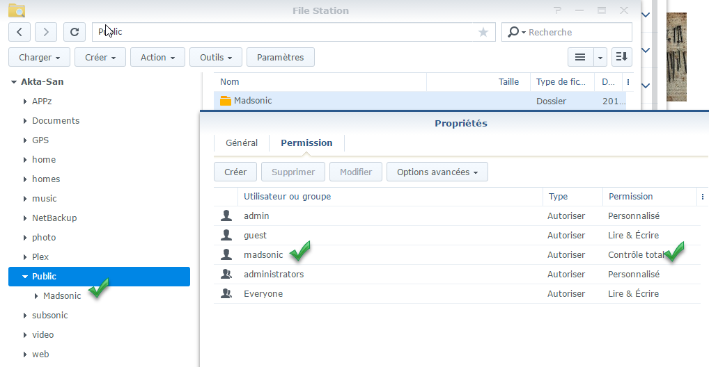

Merci de m'aider
I have a "public" folder with a "Madsonic" subfolder ...
I can't give permission to madsonic user because it doesn't exist anymore since I unsinstall completely Madsonic ...
So I created a user called "madsonic" and give full permission to public folder
WITHOUT ANY SUCCESS
Still the same error message in my madsonic_package.log file :
09.12.16_08:43:25: Can't find a folder named 'Madsonic' in your public folder.
09.12.16_08:43:25: Please check your public folder and make sure there is a folder called Madsonic (with Capital M) in it. Or select 'No' if you don't want to restore anything and just install Madsonic normally

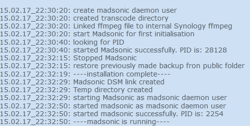

HOW to backup settings/database before installing a new vers
Hi all,
I read the question a lot on how a user can backup all his important settings before updating to a newer version of madsonic.
I did not find an answer to this yet.
Can anyone point me to a post/thread, if it already exists, or give me 3 lines of text, telling me what to do when I plan to update the madsonic server, but don't want to start from scratch with all the settings.
Thanks.
Thanks.
