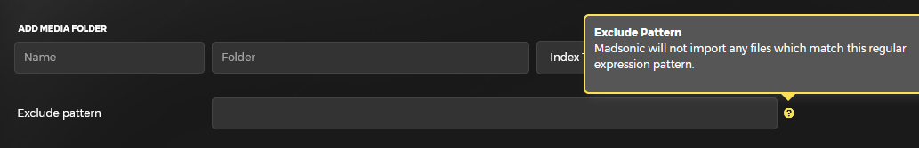

Re: Exclude art folders from scans
Aktarus wrote:
07 Jul 2019, 15:36
Question, what is the exact syntax to exclude Extrathumbs ans Extrafanart folder from scan :?:
I'll guess, you have to try yourself :-)
But as fas as I can see in -> Settings -> Media Folders you can use regex to create crazy patterns.
Multiline Textfield would be so much easier for nun regex-users :-) But then, others will complain about missing flexibilities...
Try the | to add an OR expression, like (Extrathumbs) | (Extrafanart)
Maybe this helps for starting?
Online regex tester and debugger
Regex match folder and all subfolders

I use this expression and works well for me. You may need to amend it depending on your requirements and folder names:
(?i)scan\w$|(?i)cover\w|(?i)artwork$|(?i)scans covers$|(?i)album[ ](?i)art$|(?i)art$|(?i)images$|(?i)scans[ ](?i)deluxe$
You can try inserting Extrathumbs and Extrafanart in a similar style but definitely worth checking out the links on Regex that Matt posted so you can make it work for your setup.
