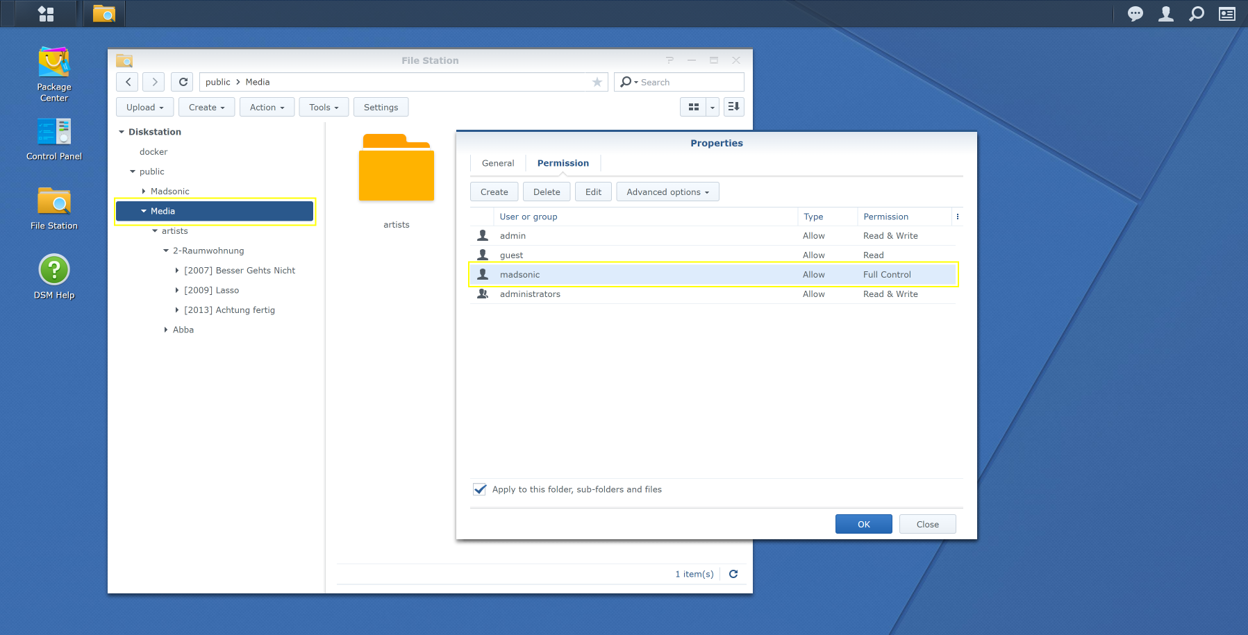

here are some screenshots of the latest test installation on a Synology 3615 with DSM 6.1.4 and Madsonic 6.3.9840 installed.
* Check on the about page, if you have a working ffmpeg version (version in green is ok | error message in red)!
* Don't forget to set the permission on you media folder for the madsonic service account!

I stared at permissions and paths endlessly... However it hadn't occurred to me that uninstalling Subsonic would remove the created Subsonic user, and thus remove the permissions for my music share.
When I reinstalled, the new Madsonic user was created, but the permissions weren't put back, which makes perfect sense now looking back.
As much as I stared at the folder permissions it all looked ok. What was actually the case was the the Subsonic user still had permissions, but the newly created Madsonic user didn't. And I was blind to that, no matter how long I stared. It took the support email above and a few days away, to go revisit again and it was staring me in the face. I fixed the permissions for the Madsonic user and all was fine.
