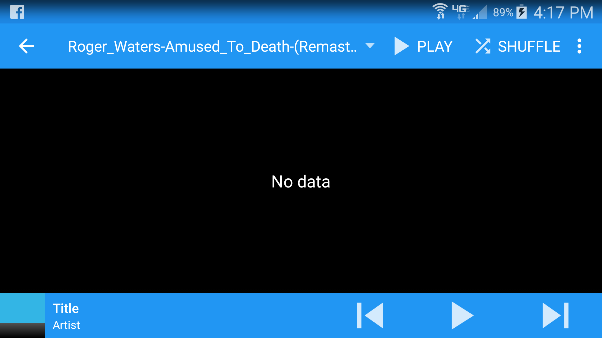

with the latest Dsub install. I get no data while browsing through folders where there is data.
Thanks Taoism.

It appears that it is because DSub is falling back to the Subsonic emulated version and using tokens. If Mad just copied the same code from Subsonic then it probably suffers from the same bug where LDAP users will not work using tokens.
PS There is a bug in the current version of DSub where the token is not refreshed after changing the username/password so you will need to clear it from memory to try a different user.

Tokens appear to still not work on latest build:
pass=dsub
salt=6i1t5qe1sqljv2pd0nqesc3eii
token=bfabec378880234916c3307b9fd1db9f
echo -n dsub6i1t5qe1sqljv2pd0nqesc3eii | md5sum
Yet I get a wrong username/password error. Issue appears to only happen with LDAP users.
