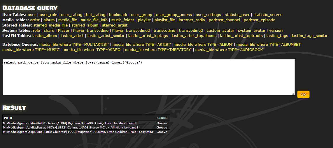

go to the db.view and start this query
with this query you can find your active genre tags in your lib.
if this entries not present you should run the Database pruge.
Attention The genre tags are cached between scans to get more performance, maybe a service restart could be necessary.
SQL
SQL
select path,genre,present from media_file where lower(genre)=lower('Groove')
