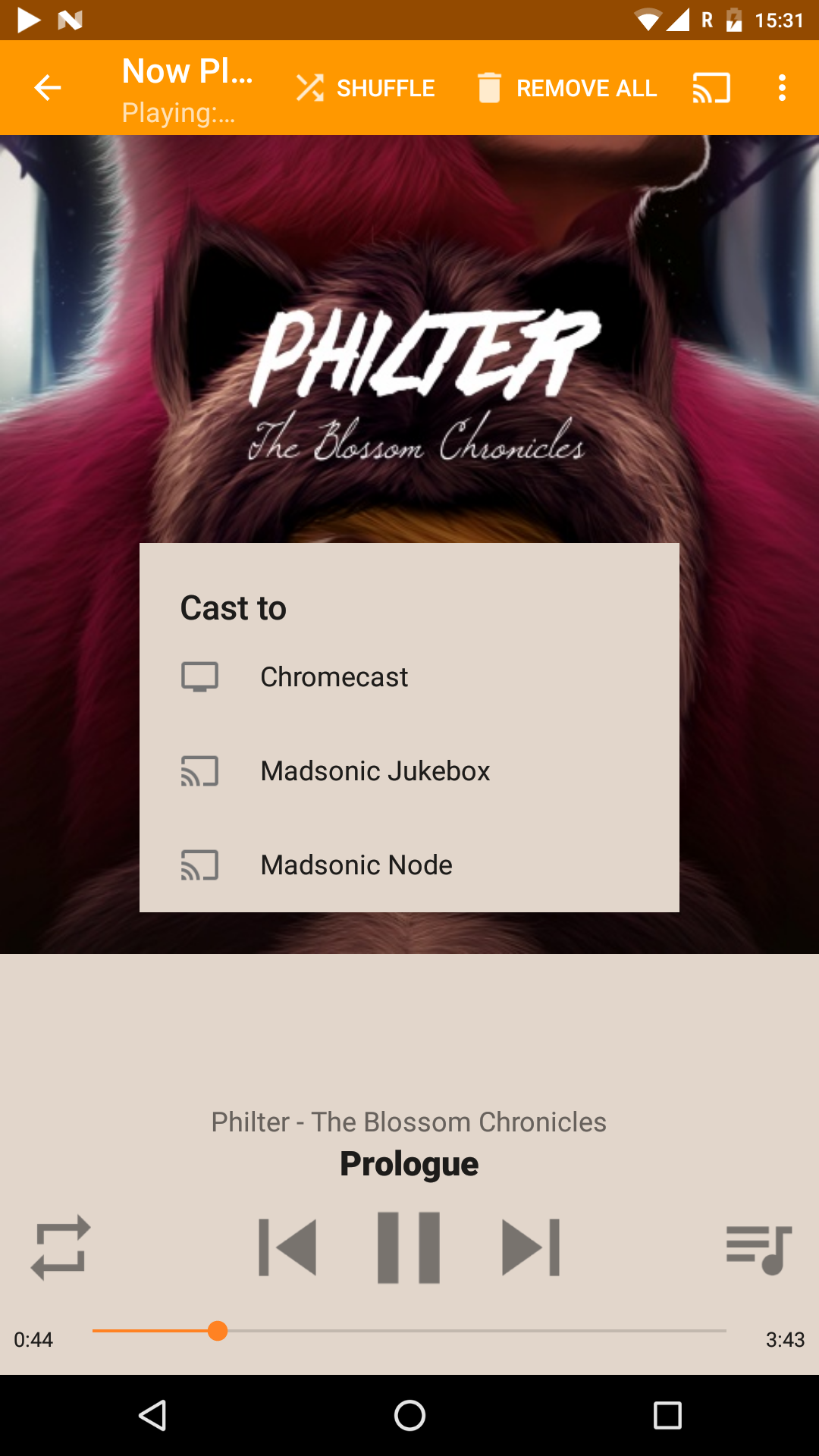

To simplify the configuration and handling of the Madsonic Node the new upcoming versions
* Madsonic Server 6.3
* Madsonic Node 6.3
* Madsonic Android 6.0
have a fully integrated solution.
