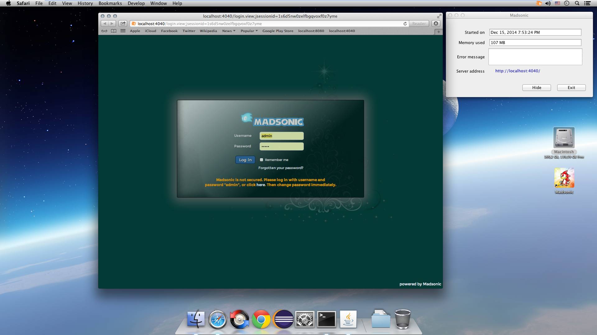

Did you use the new OSX installer?
Please try the following:
open Terminal.app
cd /Applications/Madsonic.app/Contents/Resources/Java/
java -cp madsonic-booter.jar org.madsonic.booter.Main -mac
you should see something like this:
Dez 15, 2014 7:47:04 PM org.springframework.context.support.AbstractApplicationContext prepareRefresh
INFO: Refreshing org.springframework.context.support.ClassPathXmlApplicationContext@67abaab: display name [org.springframework.context.support.ClassPathXmlApplicationContext@67abaab]; startup date [Mon Dec 15 19:47:04 CET 2014]; root of context hierarchy
Dez 15, 2014 7:47:04 PM org.springframework.beans.factory.xml.XmlBeanDefinitionReader loadBeanDefinitions
INFO: Loading XML bean definitions from class path resource [applicationContext-mac.xml]
Dez 15, 2014 7:47:04 PM org.springframework.context.support.AbstractApplicationContext obtainFreshBeanFactory
INFO: Bean factory for application context [org.springframework.context.support.ClassPathXmlApplicationContext@67abaab]: org.springframework.beans.factory.support.DefaultListableBeanFactory@4a8acc0c
Dez 15, 2014 7:47:04 PM org.springframework.beans.factory.support.DefaultListableBeanFactory preInstantiateSingletons
INFO: Pre-instantiating singletons in org.springframework.beans.factory.support.DefaultListableBeanFactory@4a8acc0c: defining beans [deployer,frame,controller]; root of factory hierarchy
Using WAR file: /Applications/Madsonic.app/Contents/Resources/Java/madsonic.war
Extracting webapp to /Library/Application Support/Madsonic/jetty/5420
Using GZIP-compression for REST
2014-12-15 19:47:04.651:INFO:oejs.Server:jetty-8.y.z-SNAPSHOT
2014-12-15 19:47:07.831:INFO:/:Initializing Spring root WebApplicationContext
Dez 15, 2014 7:47:07 PM org.springframework.web.context.ContextLoader initWebApplicationContext
INFO: Root WebApplicationContext: initialization started
Dez 15, 2014 7:47:07 PM org.springframework.context.support.AbstractApplicationContext prepareRefresh
INFO: Refreshing Root WebApplicationContext: startup date [Mon Dec 15 19:47:07 CET 2014]; root of context hierarchy
Dez 15, 2014 7:47:08 PM org.springframework.beans.factory.xml.XmlBeanDefinitionReader loadBeanDefinitions
INFO: Loading XML bean definitions from ServletContext resource [/WEB-INF/applicationContext-service.xml]
INFO: Loading XML bean definitions from ServletContext resource [/WEB-INF/applicationContext-security.xml]
Dez 15, 2014 7:47:08 PM org.springframework.security.config.SecurityNamespaceHandler <init>
INFO: Spring Security 'config' module version is 3.2.5.RELEASE
Dez 15, 2014 7:47:08 PM org.springframework.security.config.http.FilterInvocationSecurityMetadataSourceParser parseInterceptUrlsForFilterInvocationRequestMap
INFO: Creating access control expression attribute 'permitAll' for /**
Madsonic starts and you can see the whole start procedure, after some seconds the Madsonic tray icon should appear.
Not all error/warnings will be logged into the file, maybe some strange errors can only found on the debug console.
Madsonic logfile can be found here: /Library/Application Support/Madsonic/madsonic.log
