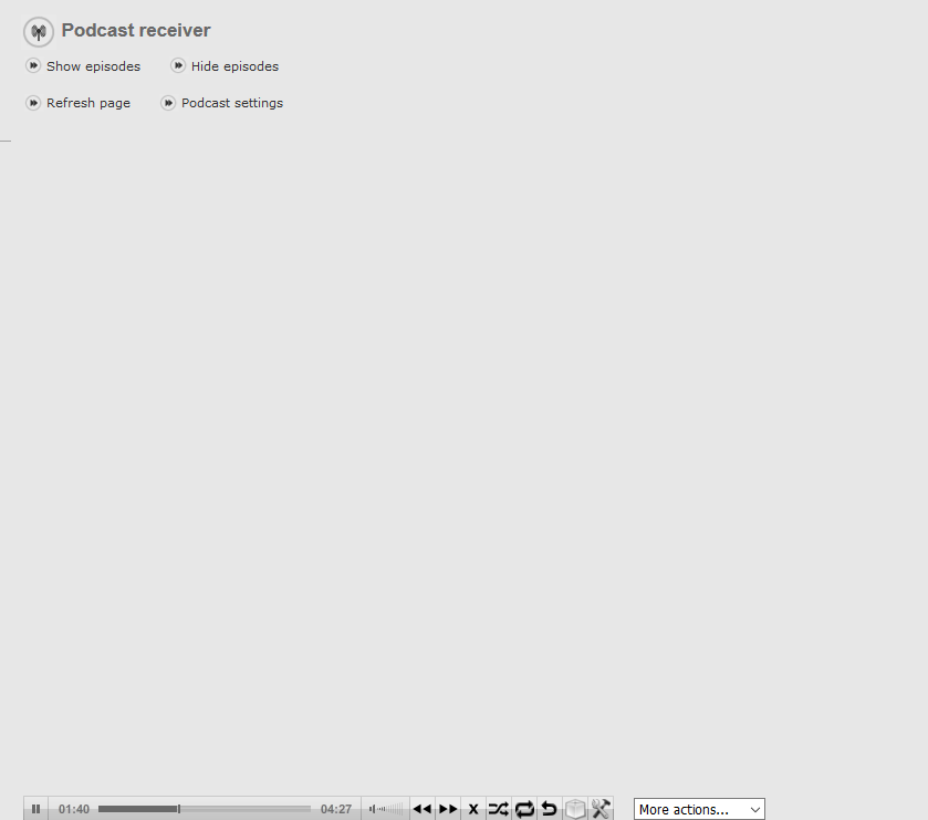

Used Subsonic for a few months and then switched to Madsonic, been using for well over a year. I have never used the Podcast functionality and decided I wanted to try it out so I could listen to them on my way to work. Well, either I am doing something wrong or there's and issue here.
All I see when I go to Podcasts are (Show episodes, Hide episodes, Refresh page, Podcast settings), I don't see the box where you would enter the feed URI that I've seen in some screenshots. At first the location to save podcasts was /var/media/podcast, but I changed it to /mnt/subsonic which is a mounted CIFS share.
Madsonic running as: root
root has rights to both locations.
Have refreshed library.
What am I missing?
Thanks
utahbmxer
Joined: 31 Mar 2014, 05:58
Re: Add Podcast?
Unread post by utahbmxer » 21 Sep 2015, 19:50
I figured it out. I just thought that since I was an admin I had full control, but it turns out I must have turned off the option to administer podcasts. Once I enabled this option for my user account it showed up. It was a Layer 8 issue.
