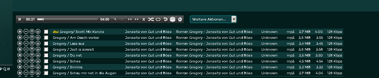

The newest versions of madsonic cut off the top row of the play queue so that you cannot see it nor select it. It seems to be behind the player. Here is what it looks like:
https://app.box.com/s/wby8h50wbuqaf0n2vark

hmm nope, this is not an server (5420) issue. this is an style issue.
i'm using madsonic- holotron
as you see, nothing cut off.
whats your style called ?

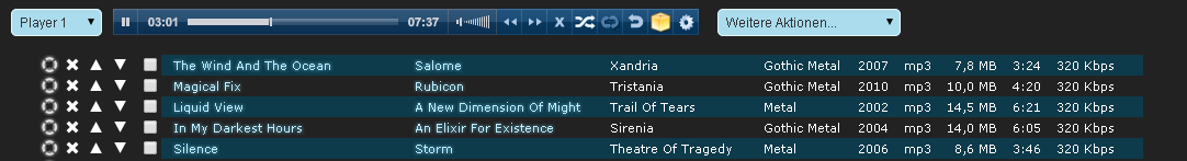

EDIT:: OK frozen Xmass
BUT this is neither an server, nor an style issue.
The upper pic is chrome .
And this is fire fox with your used style and full play queue
everythings fine.
